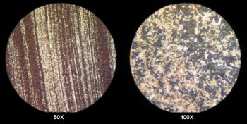

Thank you for the kind words sir, it always registers strongly in my heart to hear that anything I have to offer has helped others in our journey; I also need to send out a warm thank you to your mentor, his confidence in my information is inspiring.
On the topic of the directional properties of steel, it is best observed in extreme cold working, which is very anisotropic. Wrought iron is like an exaggerated caricature of steel with directional issues and when you cold-work it frays almost like a cable; if you score it and bend it like you are going to break it, it will look like string cheese in the inside surface. If you cold-work steel until it fails the lines of failure will be lengthwise, in the direction of working, to a lesser degree but similar to the wrought iron.
Here is a clearer example:
These are images of O-1 tool steel, and a good batch at that. The image on the left is an overall picture of how the material consists of line of flow that run in the direction of the mill rolling operation. This “grain” direction has nothing to do with the actual grains that make up the phases of the steel, which is illustrated by the image on the right. The image on the right is the same steel at over 400X where you can see that within the larger flow lines are the phases (martensite, carbide, ferrite, austenite, etc…) made of what the actual crystalline grains of the steel. The crystalline grains are more isotropic, in that with heat treatments we can remake them and alter their orientations. But you can also see how the larger anisotropic flow lines of the steel can have an influence on the directional properties of the phase grains as well. No matter how you look at it steel is really cool stuff with all it has going on.

Kevin, I notice even at the 400 mag I can still see a somewhat linear direction to the gold and black (blurring my eyes a bit to ignore facets) That would be the "toothiness" you spoke of earlier? Anyways...you will all be pleased to know my blades now come from the stock the correct direction. Lol...
Thank you again for your excellent info!
...Kevin, I notice even at the 400 mag I can still see a somewhat linear direction to the gold and black (blurring my eyes a bit to ignore facets) That would be the "toothiness" you spoke of earlier? ...
The directional properties tends to create zones if differential formation of the phases, often carbide precipitation. This will cause slightly different levels of abrasion resistance and even varying strength levels, that could wear just a little differently in sharpening, but even more so in use, so that you end up with a "toothy" effect. This is the same effect you get with Damascus on edge properties. It can be a plus on soft fibrous materials like meat, fine cloth, paper etc... but is not so great in really fine push cuts and harder materials.
