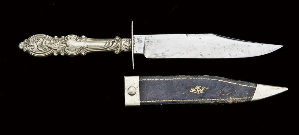

What is the proper terminology for this ricasso???
C Craft
Definition for Ricasso: A Ricasso is an unsharpened length of blade just above the guard or handle on a knife, dagger, sword, or bayonet.
This is what comes to mind when I think of the word Ricasso. The Ricasso extends down even with blades edge.
images
Pic borrowed from the net!
Notice this ricasso does not extend to the blades edge! So what I am asking is there a name for this type of ricasso that is terminated short of the blades edge???
