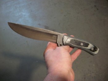

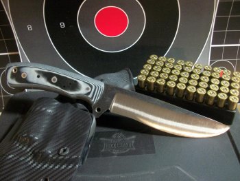

The war fighter
franklin
The warfighter.
1/4 thick 5160 steel mill finish left on
flat ground to .015 5 and 1/2 long blade
Rc 59 scales micarta from Tracy
loveless bolts and carbon fiber pins
All comments welcome dogs.

Nice! Very tough looking, multipurpose blade. I must ask though, what is the significance of the smaller pins in the scales?
Anthony, absolutely nothing lol I thought it might look cool. Oh and mean more work for me :)
Ha! I sat there and studied that for a while and was sure it had a meaning. I kept trying find a relation between 13 and 31 or 1:3 vs 3:1.
Franklin - that sure does look good - and black pins do set the handle off.
Ken H>
Oh that's funny Anthony next time I will put a meaning into it and see if you get it
Thanks for looking guys, Demo she is a brute you don't now till she is in your hand.
Awesome looking knife.
I have a beginners question about it.
First off please excuse my ignorance as I am only now making my first knife via stock removal method. I have been adding handles to pre-made knife blanks for a few years now though.
My Newby question is- is there a purpose to the hole in the guard or is it just for decorative purposes?
I have seen other knives with holes in thw guard before yours and have wondered at their purpose.
Sent from my SM-G900T using Tapatalk
Sorry sassinator been off sight for awhile, for this one it's two fold 1- for lashing to a pole 2- if you put cord from hole in guard to the thong tube becomes like a D- guard some like that better then just wrapping cord around wrist. Ask all the questions you want and hope to see some knives from you.
