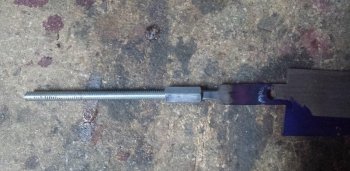

The idea here is to maintain a lighter glade but still a strong handle. By putting a pommel piece on it will maintain the pressure on the handle. A welder friend of mine says that you can't weld 440c as it just won't work so this was the next best I could come up with and verify it is a strong connection. I'll do a JB weld on the inside and smooth out the sides to make the connection smaller. Inside the handle material, I fill it with an epoxy anyways, prior to inserting the bolt.
The process is simple and there are no concerns as to a solder or glue/resin coming apart down the road as it is a mechanical connection. This is for a carving set so it won't get heavy field use, but looking back on it, the hole there that is put in at the request of the heat treater will be put further back in the future and ground off as to not weaken the tang.
Any experts out there have any thoughts? Suggestions are always welcome.

Those perfectly square cuts right where the tang and blade meet are just as weak as the hole in the tang for the heat treater. A smooth radius would be much stronger.
is there any reason you couldn't thread the tang before heat treat, then just clean it up a bit after? 440C is pretty dimensionally stable, certainly enough for the coarseness of the threads you're cutting...
Thanks for the input. I had this set water jet cut prior to sending it for heat treat. I didn't come up with the threading system until after I got the pieces back from HT. It came about when I was not happy with how my original set up was done so I was looking for something more secure. The idea came one night about 3am when I couldn't sleep. For future pieces I'll definitely do threading prior. I even had a set of CPM-3v I thread pre-HT and they came back awesome.
