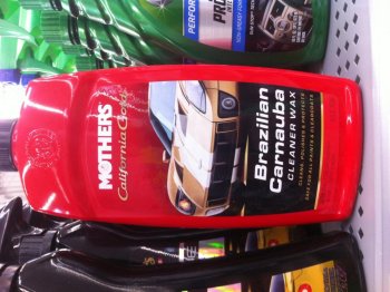

Wax on.....wax off! :) Dump the oil, and use a good paste wax on your knives....just about any brand of automotive paste wax works well, as long as it doesn't contain silicone. Personally I like Mother's brand caranuba cleaner/wax (about $12 at Walmart). It just a matter of finding what you like...many makers love RenWax.... I keep it in the shop too, but its one of those that you have to learn that a little goes a long way, and you have to be sure not to let a heavy coat of it dry on the knife, othewise you can literally see the wax on the knife. Wax protects better and longer then oils, doesn't draw dirt/dust, and can be used on the entire knife with no problems. I can't remember the last time I ever used any type of oil on a knife.

I'm ordering some, just didn't want to wait for shipping on this one. Told guy I would ship this week. Going to try Ed's stuff for now, but I look forward to trying both. Maybe a little side by side test would be fun.
Anthony..... thats the exact brand I like (the pic you posted), but I prefer the paste type wax.....only because the liquid stuff can be difficult to get out of nooks and crannys. :)
