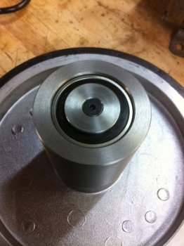

Got a bit more done this weekend. Picked up the bearings locally at Grainger. Bearings are 25mm ID and 50mm OD.
Made a housing from a 3" x 3" round of steel, bearings were pressed in on each side. Made a spindle to press into the bearings. Everything is press fit together with .0004" interference fit. Purchased a 10" contact wheel from Grizzly, the bore was .003 over 3/4", so I made the spindle .002 over for a nice slip fit. Thanks for looking, Larry

Mounted the Grizzly contact wheel on the shaft that I made, and made a collar for the end. This shaft runs on large high speed (8000 rpm), 52mm bearings. The advantage of this arrangement is that I can make and mount any size wheel from 7/8" and up by just taking out 1 bolt on the end and removing the Grizzly wheel.
The bearings are mounted in the 3" diameter housing, that is mounted on a piece of 1/2" steel that is adjustable in and out by loosening and tightening the large knobs on the left side.

On the Grizzly wheel did you machine bearing pockets in the wheel or is it unmodified, running on a shaft? I put pockets in mine and set bearings in it. I'm curious how yours is, because mine has a tiny wobble. I thought my machining was good, so wonder if it's slop in the bearings. I'm anxious to hear how true yours runs.
Anthony, no the wheel is unmodified. The bearings are in the housing, I was very careful to machine both sides accurately, but we will see. And I will let you know.
I couldn't see a good way to machine pockets in the Grizzly wheel without machining both faces to make it true. The wheel is cast, not machined.
I looked at my Grizzly for a while and noticed the inner lip on one side was machined. I figured they cast it and grabbed it somehow to machine that lip, then bored center out concentric to that. So, I chucked it on the inner lip. I had my bearing pockets a little on the tight side and had to tap them in. Maybe one didn't seat exactly square, it's not bad, but at high rpm I notice it if I try to grind right on the edge of the wheel. The way you did it is probably better overall.
