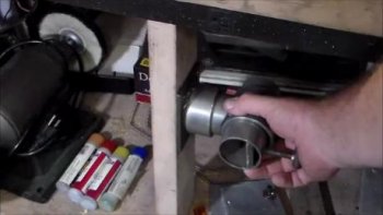

I made 3 places on my bench that the vise can be mounted. The one on top will probably be the most used. Another is on the face of the bench, in case I need to work on the pommel of a long knife. And a third, down low on one of the bench legs. This one is low enough I can sit in a regular chair instead of a stool and it'll probably be where the vise is stored when not in use.

Hey, guys, wanted to update you on the knife vise tutorial/video I put out a last month. In full disclosure, after using it for a while, I have found one design decision that I would recommend against. Not a big deal, especially if your tubes nest tightly with each other, but mine are a little loose.
In the video mainly, I discussed putting the outer tube clamping T-bolt over at 45 degrees, instead of centering it on the top. While it does feel very convenient at this location, I see now why everyone puts it in the center. If your tubes have a little play, gravity keeps the inner tube centered in the bottom. When you bring a clamp in at 45 degrees, the tube has a tendency to lift and rock over a little until it meets the opposite wall.
Again, not a big deal, just want to warn you that you might rather keep it at top dead center. It doesn't bug me enough to change mine, but if I were to do it again, I'd change.
