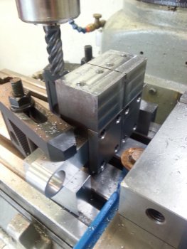

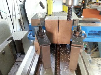

Next will be the clamp arm posts that will hold the work rest. They are 2” square 1018 cold roll. I machined them in pairs so they are identical and everything will stay square.
