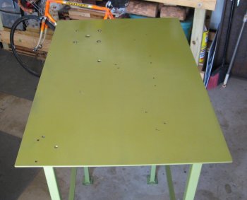

1st photo shows the base plate with all the holes drilled and tapped.

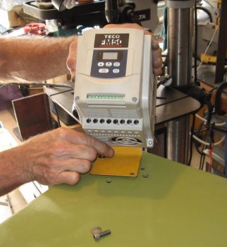

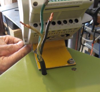

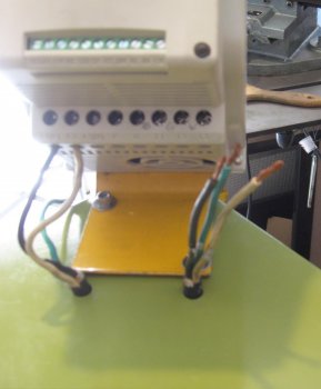

2nd photo shows the variable phase converter being installed. The bracket that it is mounted on is part of the belt guard off of a riding mower.
3rd photo shows the power cord coming through its hole in the base plate.

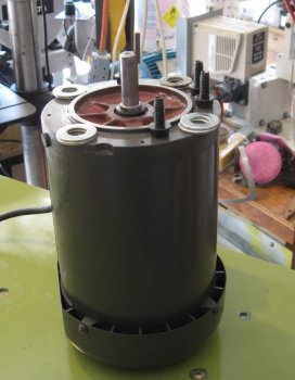

4th photo shows the motor,sitting on the baseplate before it's installation from the bottom side of the baseplate. This is a C face motor so the mounting bolts go through the base plate and into the face of the motor. The washers provide spacing between the motor face and base plate.
5th photo shows the motor shaft protruding through the base plate and the bolts that hold it in place. That motor is 2 hp 3460 rpm 240 volt 3phase.

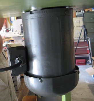

1st photo shows the motor in place under the base plate.

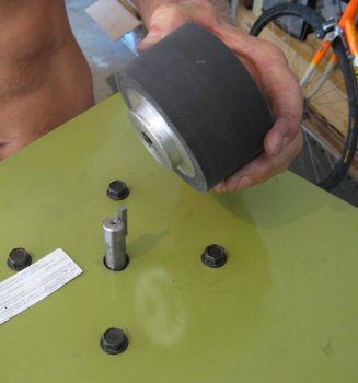

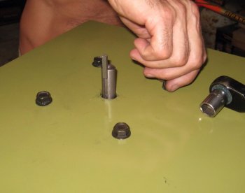

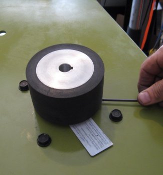

3rd photo shows the drive wheel being installed onto the motor shaft.
4th photo shows the wheel in place with a shim to keep it off the base plate while the set screw is being tightened on the motor shaft key.

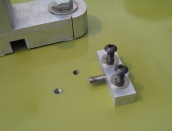

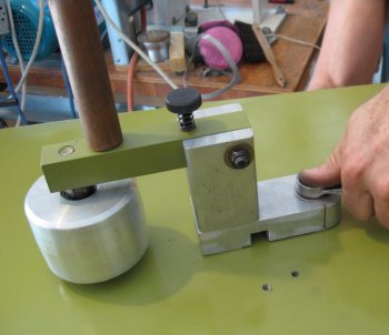

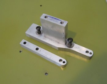

1st photo shows the tracking/tensioning device that we built. We bought the knurled tracking adjust screw from Beaumont.
2nd photo shows this device in position.
3rd photo shows Paolo tightening the nylock nut on the bolt,there is a fine line between too tight and just right!
4th photo shows the tension spring mount.
5th photo shows the tension spring in position to do its job.

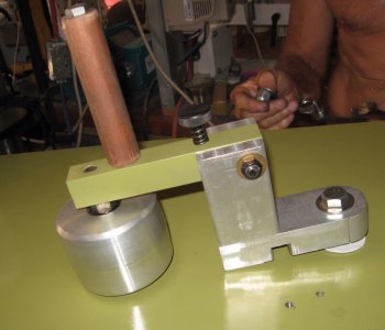

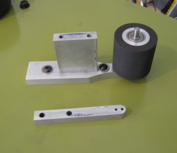

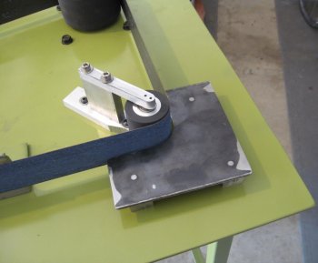

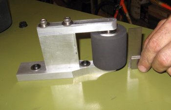

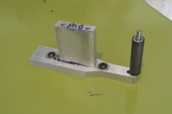

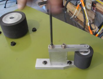

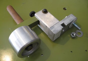

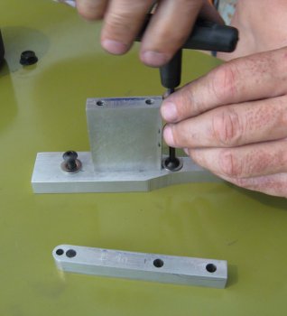

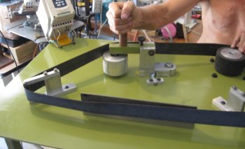

1st photo shows the small wheel holder we built,based on the Bader design.
2nd photo shows this holder being mounted in place.
3rd photo shows the 2" wheel in place.
4th photo shows the top arm of this holder being put in place.
5th photo shows that the wheel needs to be perfectly perpendicular to the base plate so that our grind lines will be perpendicular to our flats.

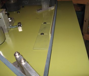

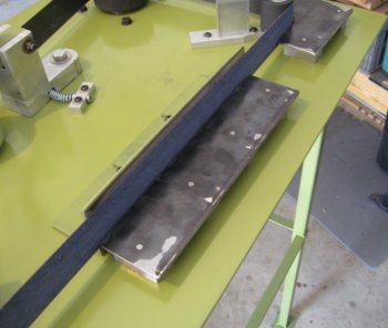

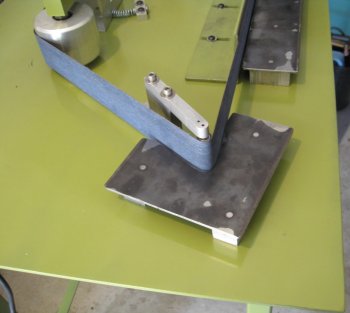

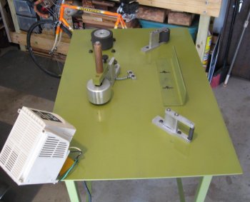

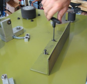

1st photo shows the flat platen.
2nd photo shows the other small wheel holder.
3rd photo shows the flat platen being bolted into position.

1st photo shows the base plate and all pieces assembled in place except for the tool rests.
2nd and 3rd photos show Paolo installing a belt.
4th photo shows how the belt runs from wheel to wheel across the platen.

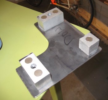

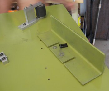

1st photo shows the tool rest for the 2" wheel in place.
2nd photo shows the aluminum legs bolted to the tool rest and the super strong magnets that allow for quick removal or positioning.

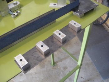

3rd photo shows the bottom of the tool rest for the platen and the 4th photo shows the tool rest in place.
5th photo shows the tool rest for the 1/2" wheel.
At the time we took these photos we had not yet built the tool rest for the 4" drive wheel but,you get the picture,don't you?

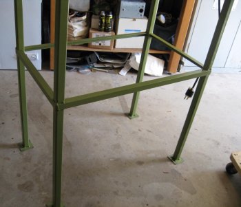

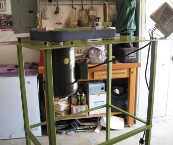

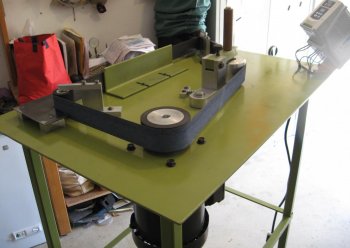

1st photo shows the grinder completely assembled,from behind.
2nd photo shows another rear view with a better view of the motor.
3rd photo shows the power pigtale, long legs and angle iron where a shelf will be attached.
This machine is 4' tall to the base plate.
