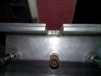

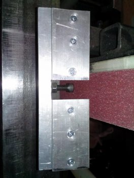

Just a update,Stezann I did tighten thing up a while back.I always indexed my file guide to the same side but from the begining I wanted a tight fit.I took my jig and after squaring some aluminum stock I faced it and now my guide fits tight with perfect 90 deg per side.

I'm not at home at the moment but I think it was 3x3 aluminum angle and the file guide was 01.I don't run right up against the guide but close.I scribe a line on top of the edge of the blade for my plunge .
