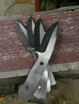

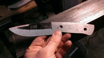

I thought I would do a wip being this is the first time I have used 1095,I was recently asked to make 4 knives for a guy's groomsmen.He wanted somthing different so we are going for a hamon line.So we have our steel and lay out the blades.5/32 1095.

Now over to the grinder to clean up the blanks and grind to my scribes lines.

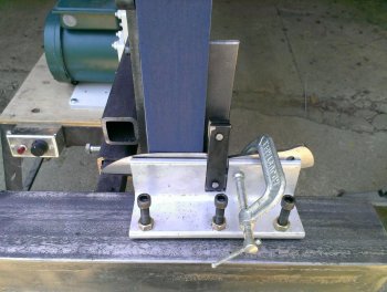

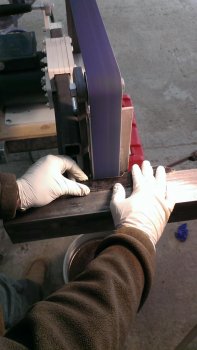

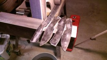

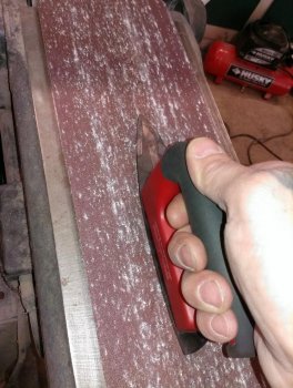

Ok next up over to the belt grinder to clean up the blanks,by the way this is my Orca model.

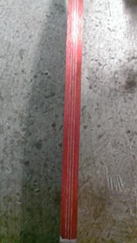

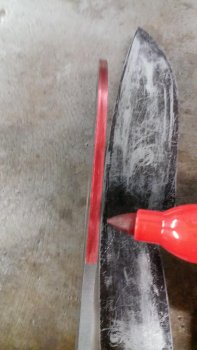

Next let's highlight our edges so we can se our scribe lines.I like to use red.

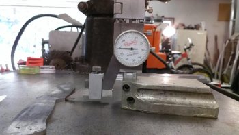

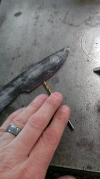

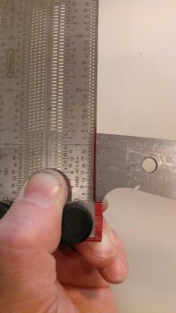

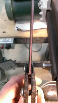

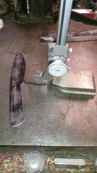

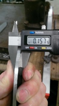

Ok now we need to mark the center line of our edge,you can do this with a drill bit or use a gauge like I do.

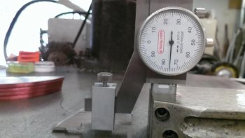

Ok to use the gauge first zero it out,next we take our stock thickness and deavide it by 2 and set our gauge to that number and scribe center.

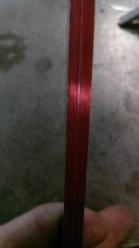

I want to leave a 50 thousands edge till after heat treat and temper so now I zero the dail,then raise the gauge 25 thousands and scribe drop the gauge past zero another 25 thousands and scribe and you have your 50 thousands edge laid out.

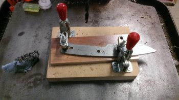

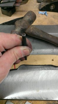

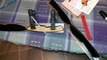

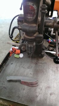

Ok next we need to put some pin holes in the tang,first lets center punch the holes.now clamp the blank down somehow,I use this jig with a scrap of laminate under the blank .Using a sharp appropriate drill bit drill your holes.

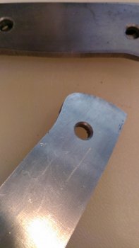

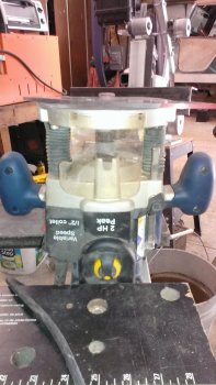

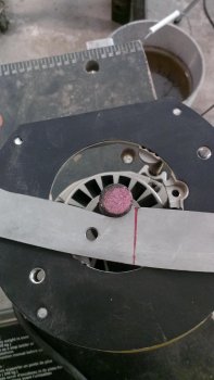

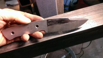

Ok so this morning I chanfered the pin holes and cleaned up the front quillons,I don't have a small wheel for my grinder so this is how I do my small radiuses.I use my variable speed router with a stone wheel and it works like a charm.

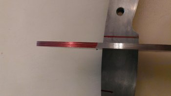

Ok now let's mark were our bevel and swage will start,I also mark the seage lines on the spine to leave 50 thousands till after heat treating.

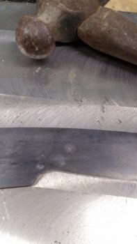

I only had time to get one blade ground out this morning,first I knock the edges off with a file,next it's over to the grinder and I put a 10 deg bevel on the edge taking it to my scrib lines,then I go back over it at 5 deg.next I grind in the swage at 20 deg to my scribe lines leaving 50 thousands till after heat treating.That's all for today dogs Paul.

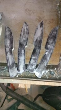

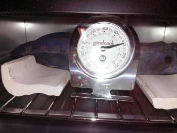

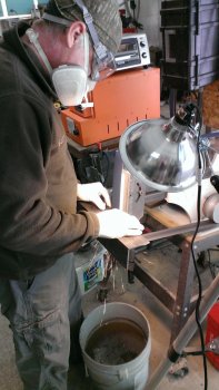

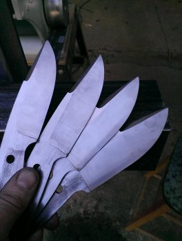

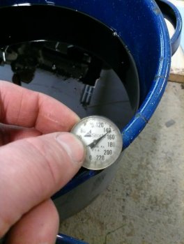

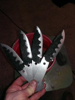

Part two,I got all 4 blades ground and ready for heat treat.I clay backed all 4 with furnace cement and let dry 24 hours,next fired up the kiln and brought the temp up to 1475.while the blades were coming up to temp I preheated my quenching fluid to 140 deg.After the blades reached the nonmagnetic stage I let them soak for 7 min and quenched.Then off to the toaster oven heated to 450 and soaked twice for two hours each letting them cool to room temp in between.

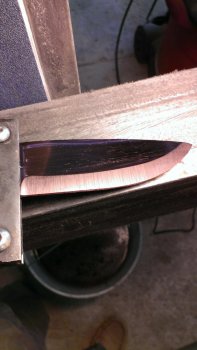

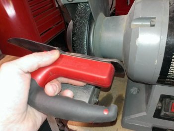

Kleen up at the wire wheel and 6 inch belt.Then final grind down to 220.Next up hand sanding.
