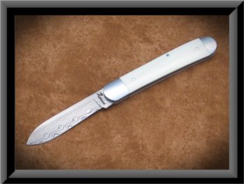

Ok,this is the knife I was working on when I started this thread. I got it acid etched,hammered together sanded and polished and I'm pretty happy with it.
The .055" damasteel blade is 2 1/4" long.
I made two,.010" thick stainless steel washers to use for anti scratch relief.
The knife is 3 1/4" long closed,5/16" thick.
410 stainless integral bolster/liners,hand rubbed to 1000 grit,416 stainless steel pins.
Elephant ivory scales,they are polished but I couldn't capture that in the photo.
Yes that's right,no nail nick,I didn't forget it,you don't need it on this easy open knife. It's thin and light,it's easy to open and it walks and talks like a Banty Rooster!
Y'all enjoy!

Amazing knife, Calvin. I bet with those dimensions, it would be a pleasure to carry. I see absolutely no signs of the abuse you alleged in your first post, by the way.:3:

great looking folder Calvin

Calvin that is a pretty little thing. You've pushed the limits on everything. Those caps would sure look pretty with some well done micro-engraved scrolls to top of off.
