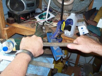

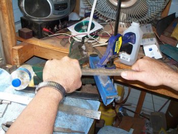

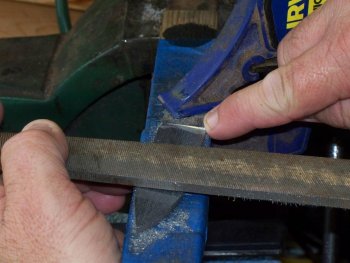

Hey Steven,not sure I understand drawfiling on the tang.I can't really tell from the pic.What most do with drawfiling is the bevels
See if any of these pic make sense,or just confuse you even more..
Pic#2 is just showing you the start of your plung line,just try and get both sides as close as you can,use your file as normal
Pic #1 and #3 is an attempt to show you the drawing process,depending on the file teeth,start at the plung and pull out,or start at the tip and push to the plung.
Good luck
God bless,
Keith

Ooooh ok. I didn't realize it was mainly or only used for the bevel. I was thinking of using this method to even out my tang but I guess it would be easier to just sand it back down flat. I accidently ground down the butt end of the tang more than the rest of the knife and I am worried there will be a gap when the handle is attached.
I think I can still drawfile the bevel down a little to get a plunge line and clean it up. Thanks for the info and pictures Keith. I'll post an update once I try this out.
Just take your time,file your plung lines first...before you start drawfiling,you dont have to complete your plunges just get then as close to the same on both sides.
As far as the tang,you can put the platten back on,and get you a magnet,I use one that is used in welding,that way you can hold it flat against the belt..or if you have
taken it down to far,just do a little taper on it,just make sure it is flat,where the scale will not have a gap.....Just remember..this first one was a learning experience
you can now get better and better...Keep us posted
God bless
