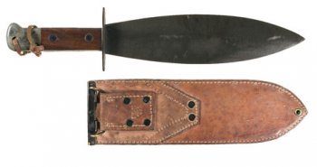

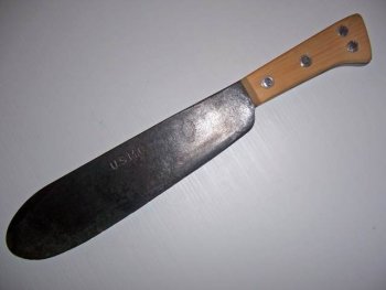

do they call that a smashet ? my POPS has one of those from his dad in wwII its hanging in the gun safe.
you know, maybe a little bit. I think the Smatchet is kind of based on a barong, which is sort of where I thought this design was steering toward. I also see a little nesmuk in my design.
The big difference with the Smatchet is the double edge, which actually makes a lot of sense for military applications where a knife might be used for digging and other abusive stuff. A double edge for me though introduces twice the risk, or even more. Not that I hit myself with the spine of my knife, but if it were a sharp edge and I did...ooops
Darci, if you are able to post a picture of that smatchet, that would be really cool.kewlpics1
my POPS has two these are the pix's he has of them.

Darcy, the knife on the right, is USMC (United States MEDICAL Corp) bolo from the Pacific Theater. I have one, and they still function great for use as choppers!
