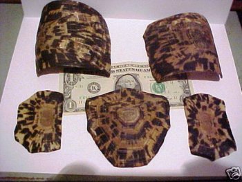

I am working on some things right now that involve different species of legal tortoise that are not endangered where the shell are available and completely legal. The problem still exists with the scutes being thin, but I've got some shell now that I'm experimenting with for scales.
This is a photo of the scutes off another species of tortoise that is legal. They have great color and texture, and they are 100% legal and moral to use.
attachment.php

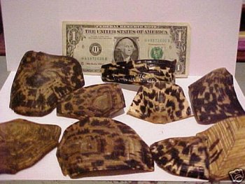

Another photo of some other scutes I'm playing with..........
attachment.php
I'll let you know how it goes.
