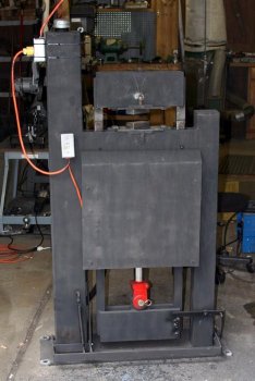

Hey Dogs, I just wanted to take a few seconds and post a little info on Uncle Al's 24 ton press. (my new press.)
This is the ONLY and first press I have used.. so I cant really compare it to the other pre made presses out there. But heres my thoughts.
First the specs. It pushes at 24 tons and has a very small foot print and is a self contained unit.. It stands 5'3" at the tallest and only 30" across and 24" deep And if you are anything like me.. Thats almost as important as how good it works! And let me tell ya. Its a metal moving machine! :biggrin:
The stroke is fast! and the dies are simple.. so I will not have a problem making or changing them out. It comes with 1 set of dies.. So I have to add that to my list of things to do this month!
In figuring out what press to get, I asked you guys and anyone else who would listen.. Thanks for your input.. As I did this I called AL... He is a very king gentleman.. He took the time to answer my many questions and phone calls. And there were many. The turn around time on my order was perfect and the delivery is awesome as well. It came FedX and took 2 days to get here after he shipped it. Thanks Al...
In a nut shell Im VERY, VERRRRY happy with my new press and would recommend it to anyone considering pulling the trigger on a press... http://riversidemachine.net/item16342.ctlg
Any advise or thoughts about these presses or your dealings with Al would be great..
Thanks, Randy Haas, HHH Knives

JEALOUS!!
Great looking machine you picked up. You know what would go good with this thread....ACTION SHOTS!!! Pictures or it never happened...:D
--nathan

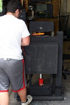

Nathon, I just added some pics of the press and Jr. working on a billet..
Delbert.. PM me with any info you might want to share on where to get the filter and how or why to use a different start switch?
Pat, You my friend are right. Im feeling VERY blessed
Stabber. Yes sir Thanks for the comments.

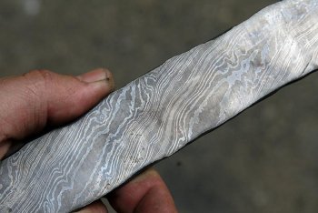

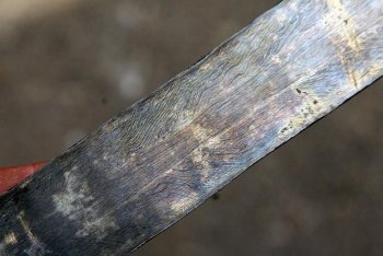

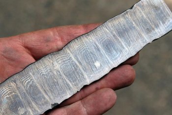

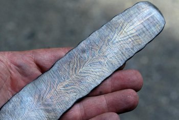

I stilll LOVE the press and have been putting it to good use! Here are a few pics of some of the billets it has made! sry about the bad pics.
Thanks again to everyone for your help and advise.
