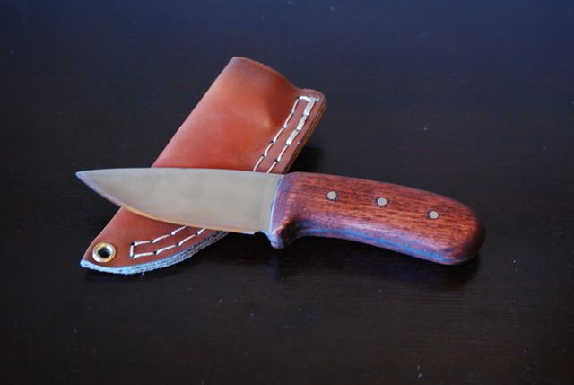

The big sheep
D2 tool steel
12cm blade, 25cm overall
4mm thick
6mm stainless pins from a bbq rack
Jarrah scales with black liners
The sheath is of my creation too

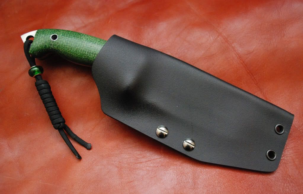

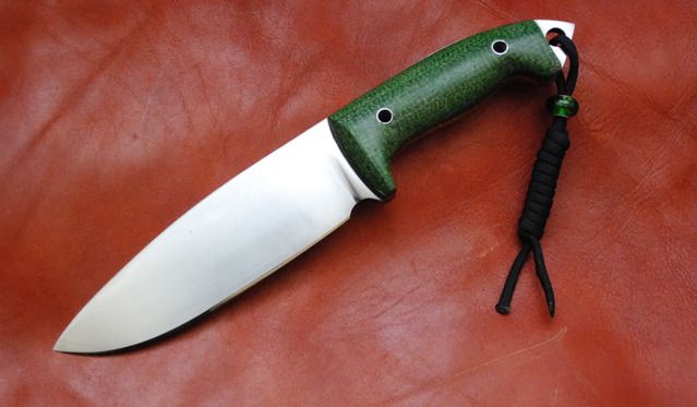

Those leaf spring knives?
This one has a 13cm blade and is 26cm overall.
5160 Spring steel(From a Mazda)
The handle is homemade Micarta from hessian and fibreglass resin.
The pins are aluminium tubing from a hobby shop.
This was also my first attempt at kydex

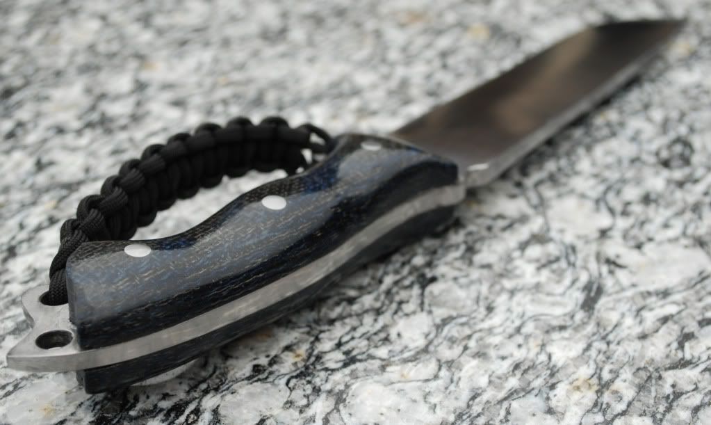

and finally this on is 36cm overall with a 19cm blade.
same steel
and again homemade micarta
Love that final shot!

Those look great Zac. I really like the one with the Green handle. What is "hessian" ?
Welcome to the Pound too
Welcome. You are off to a good start IMHO. The sheepfoot is nice, like the scales alot. But the green mazda is my favorite. Bottom unit looks good btw. Dozier
Zac, you are deffinantly doing good work. I too like the green handled knife. It has some real nice lines and you deffinantly have the home brewed micarta down right. For those of us on this side of the big pond, hessian is burlap.
